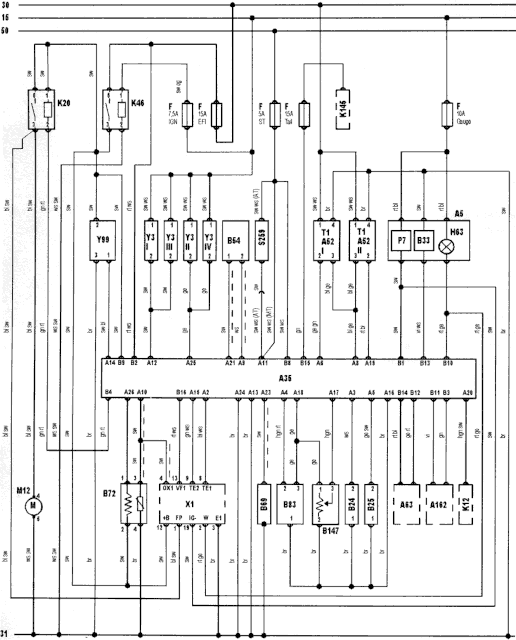

Witamy,
Tutaj taki oto obrazek jak mu przekażesz, to może rozjaśni, dlaczego nie ma. Rzeczony element to B54.
А63   AC control module
30   Battery +
31   Battery -
В54   Crankshaft position (CKP) sensor
Х1   Data link connector (DLC)
А35   Engine control module (ECM)
K46   Engine control relay
K12   Engine coolant blower motor relay
В24   Engine coolant temperature (ЕСТ) sensor
H63   Engine malfunction indicator lamp (MIL)
M12   Fuel pump
К20   Fuel pump relay
F   Fuse
В72   Heated oxygen sensor (HO2S)
Y99   Idle air control (IAC) valve
А52   Ignition amplifier
Т1   Ignition coil
15   Ignition switch - ignition ON
50   Ignition switch - start signal
А162   Immobilizer control module
Y3   Injector
B25   Intake air temperature (IAT) sensor
В69   Knock sensor (KS)
B83   Manifold absolute pressure (MAP) sensor
S259   Park/neutral position (PNP) switch
K145   Side/tail lamps relay
P7   Tachometer
В147   Throttle position (TP) sensor
B33   Vehicle speed sensor (VSS)
bl = blue
br = brown
el = cream
ge = yellow
gn = green
gr=grey
nf = neutral
og = orange
rs = pink
rt = red
sw = black
vi = violet
ws = white
hbl = light blue
hgn = light green
rbr = maroon
Dziękuje bardzo!
Przekaże to mechanikowi i poczekam na jego odpowiedź.
