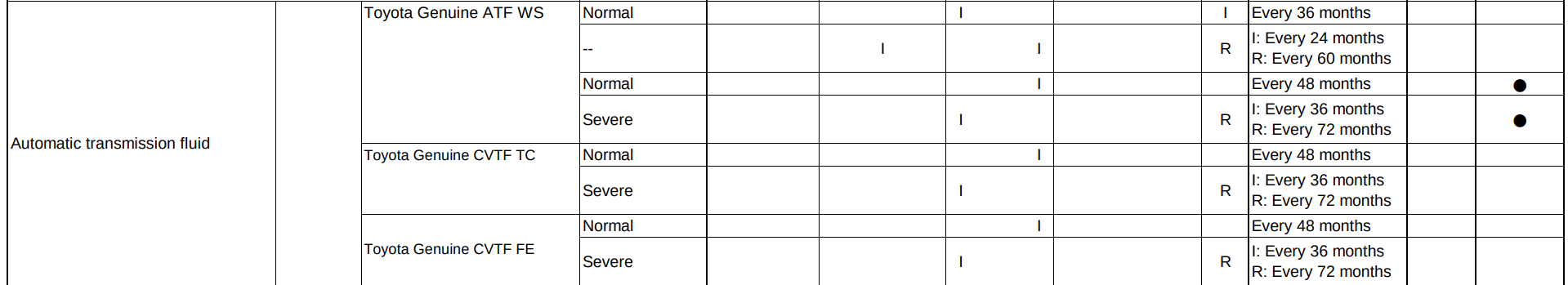

W EU, dla ZVW50 Toyota zaleca wymianę co 6 lat jeśli auto jeździ w ciężki warunkach.
Ciężkie warunki dla CVT to:
Heavily loaded vehicle. (Example : Towing a trailer, using a camper, using a car top carrier, etc.)
Continuous high speed driving (80 % or more of maximum vehicle speed) for over 2 hours.
